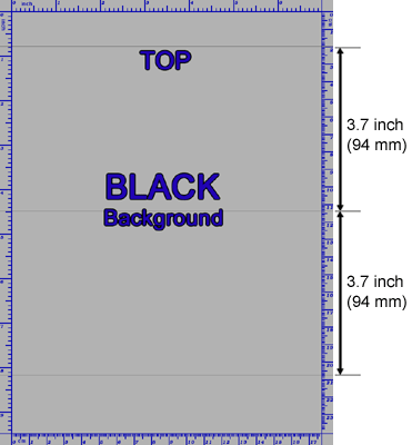

Horizontal lines repeating every 3.7 inch (94 mm)

TOP - leading edge of paper as it exits printer More information on the orientation of the paper. Clicking this icon will open a new window.
Fig. Black-2
Description
Thin horizontal lines in the color of the new print cartridge. Only one repeating line may be seen, repeating every 3.7-inch (94 mm), or the issue may appear in sets of two lines, which are 0.55-inch (14 mm) apart and repeat every 3.7-inch (94 mm).

 Troubleshooting and suggestions
  1. Turn off the printer, wait one minute, and turn it back on. This will rotate the internal print cartridge components from their original position. The 3.7-inch (94 mm) repeating line should disappear after 72 hours.
  2. After 72 hours, print out another set of test pages.
    Click   to print the test pages.
  3. Look at the new set of test pages. If the issue is not resolved, contact HP.
 Recommended parts
None. The issue should be resolved by performing the troubleshooting procedure.
