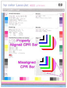

Fig. Calibration-2
Description
The CPR bar does not appear sharp. The CPR bars are misaligned More information on misaligned CPR bars. Clicking this icon will open a new window.. Users usually describe this issue as text with shadows or halos.
 Most likely causes
This issue is caused by misalignment of different colors.
 Troubleshooting and Suggestions
  1. Calibrate the printer. Show me how.
  2. Print out another Configuration page. Show me how.
  3. Look at the new Configuration page. If it does not work the first time. Try calibrating the printer again. Do not calibrate more than three times.
  4. If the issue is not resolved, contact HP.
 Recommended parts
None. The issue should be resolved by performing the troubleshooting procedure.
