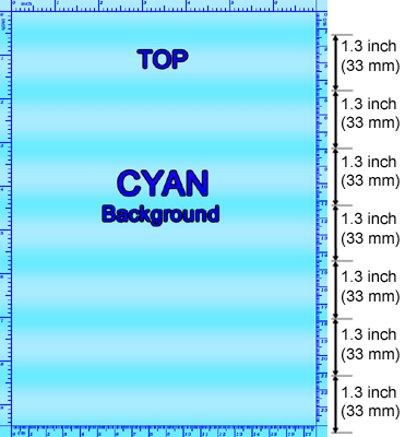

TOP - leading edge of paper as it exits printer More information on the orientation of the paper. Clicking this icon will open a new window.
Fig. Cyan-3
Description
Broad fuzzy horizontal bands repeating every 1.3-inch (33 mm).
 Most likely causes
  • Generally caused by a 1.3-inch (33 mm) developer roller inside a print cartridge Picture of the printer cartridge. Clicking this icon will open a new window. that is not perfectly round. As the roller turns, different amounts of toner are deposited on the paper.
  • The print cartridge is near the end of its life.
 Troubleshooting and suggestions
  1. The cyan cartridge is damaged. Replace the cyan print cartridge with a new cyan cartridge.
  2. After replacing the cartridge, print out another set of test pages.
    Click   to print the test pages.
  3. Look at the new set of test pages. If the issue is not resolved, contact HP.
 Recommended parts
The cyan print cartridge Picture of the printer cartridge. Clicking this icon will open a new window. may need to be replaced.
Note: It is not necessary to replace the other print cartridges.
