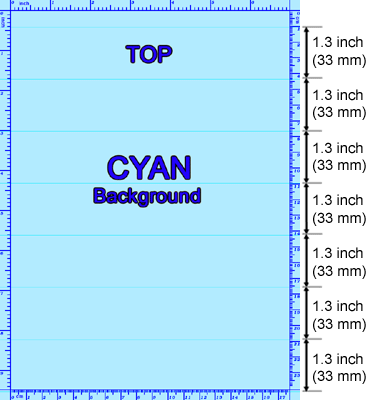

TOP - leading edge of paper as it exits printer More information on the orientation of the paper. Clicking this icon will open a new window.
Fig. Cyan-1
Description
Thin horizontal lines repeating every 1.3-inch (33 mm).
