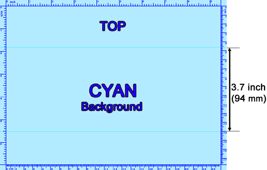

TOP - leading edge of paper as it exits printer More information on the orientation of the paper. Clicking this icon will open a new window.
Fig. Cyan-2
Description
Thin horizontal lines in the color of the new print cartridge. Only one repeating line may be seen, repeating every 3.7-inch (94 mm), or the issue may appear in sets of two lines, which are 0.55-inch (14 mm) apart and repeat every 3.7-inch (94 mm).
 Most likely causes
  • Most commonly observed shortly after a new print cartridge Picture of the printer cartridge. Clicking this icon will open a new window. has been installed. During shipment or storage, internal print cartridge components contact one another and may be damaged.
  • The print cartridge is near the end of its life.
 Troubleshooting and suggestions
  1. Turn off the printer, wait one minute, and turn it back on. This will rotate the internal print cartridge components from their original position. The 3.7-inch (94 mm) repeating line should disappear after 72 hours.
  2. After 72 hours, print out another set of test pages.
    Click   to print the test pages.
  3. Look at the new set of test pages. If the issue is not resolved, contact HP.
 Recommended parts
None. The issue should be resolved by performing the troubleshooting procedure.
