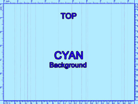

Fig. Cyan-5
Description
One or more vertical lines appearing as a continuous line or as broken 1.6-inch (41 mm) line segments. The line(s) can occur anywhere in the page. The issue may start out as one line, with more lines appearing over time as the issue gets worse. These lines will appear on all five test pages. The color of the lines will normally be different from the color of the cartridge causing the print quality issue.
