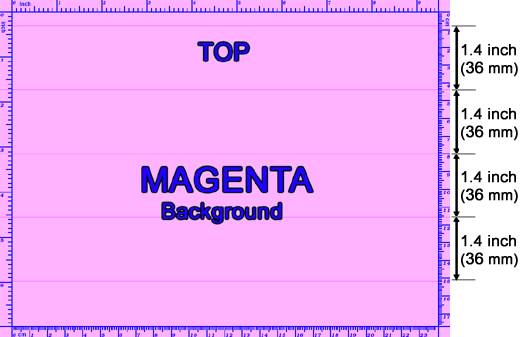

TOP - leading edge of paper as it exits printer More information on the orientation of the paper. Clicking this icon will open a new window.
Fig. Magenta-1
Description
Thin horizontal lines repeating every 1.4-inch (36 mm).
 Most likely causes
  • During shipment or storage, internal print cartridge Picture of the printer cartridge. Clicking this icon will open a new window. components contact one another and may be damaged.
  • The print cartridge is unused for three or more weeks after the print cartridge is opened and all packaging materials are removed.
  • The print cartridge is near the end of its life.
 Troubleshooting and suggestions
  1. The magenta cartridge is damaged. Replace the magenta print cartridge with a new magenta cartridge.
  2. After replacing the print cartridge, print out another set of test pages.
    Click   to print the test pages.
  3. Look at the new set of test pages. If the issue is not resolved, contact HP.
 Recommended parts
The magenta print cartridge Picture of the printer cartridge. Clicking this icon will open a new window. may need to be replaced.
Note: It is not necessary to replace the other print cartridges.
